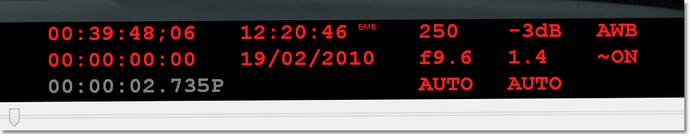

The metadata is displayed in five columns immediately below the main video display. If any items of metadata are not present in the file they will appear as a series of "-"s.
Metadata window pane
•Timecode - semi colon between secs and frames denotes drop frame
•User Bits (also called "Binary Group")
•File Progress Timecode - this is a timecode generated by DVMP Pro to show the progress into the file. It is not an item of metadata and is therefore displayed in grey. The timecode always starts at zero at the beginning of the file and increases unbroken to the end of the file. It effectively shows the absolute frame number of the currently displayed frame. For HDV, AVCHD and MPEG-2 PS files this is replaced by the Presentation Time Stamp (see notes below).
•Frame Type - this is the frame type I, P or B and is only displayed for HDV, AVCHD and MPEG-2 PS files, and for some MOV and MP4 files.
When paused or frame-stepping the file, progress timecode turns yellow if the current frame is a "dropped" frame (for DV formats only).
Currently, file progress timecode is not displayed for HDV, AVCHD or MPEG-2 PS files. This is due to the nature of the MPEG-2 and AVCHD format which would need the whole file to be scanned before playback could begin. However it can be selected for the Burn-In tool as this effectively scans the file as it goes.
When playing HDV, AVCHD and MPEG-2 PS files the file progress timecode is replaced by the Presentation Time Stamp (PTS). This is not an item of metadata but a timestamp stored in the file structure for each frame. Each frame has a different PTS and is therefore helpful in uniquely identifying each frame when you are frame-stepping, particularly as the other metadata values may not change for several seconds. The PTS is displayed in the form hh:mm:ss.sss where ss.sss is the number of seconds (milliseconds after the decimal point) - it therefore looks similar to a timecode (hh:mm:ss:ff) but it counts fractions of a second rather than video frames. Note that the PTS values are stored by the camera and they might not start from 0 at the beginning of the file. The PTS is only displayed in playback - when using the Burn-in Metadata tool it is the File Progress Timecode that is burnt-in.
•Time of Recording - hh:mm:ss
•Date of Recording - mm/dd/yyyy, dd/mm/yyyy or yyyy-mm-dd selectable via Tools > Options > General menu
•AM/PM Indicator - only displayed when 12 hour am/pm format is selected
•Metadata Source - the metadata source being used: EMB, HDR, HDA, THM, MOI, MPL, DTC or DTM
•Date/Time Adjustment Indicator - a plus-or-minus symbol ± appears if the displayed date or time is adjusted
Date and time of recording is sometimes referred to as "datacode" or "datecode".
By default the time of recording is displayed in 24 hour format. But if the 12 hour am/pm format option in Tools > Options > General has been selected, an AM or PM indicator appears after the time.
The Metadata Source is selected via the Tools > Options > Metadata Sources menu.
Metadata Source and Date/Time Adjustment Indicator both appear to the right of the Time of Recording.
The Date/Time Adjustment Indicator appears only if the displayed date and time has been adjusted by the Adjust Date and Time by option in Tools > Options > Metadata Sources.
•Shutter Speed - e.g. "50" denotes 1/50th of a second
•Iris - Aperture setting (F-stop)
•Auto Exposure Mode - Automatic, Gain Priority, Shutter Priority, Iris Priority or Manual
•Gain - in dB
•Focus Distance - distance from the camera in meters
•Focus Mode - Manual or Automatic
Focus distance and focus mode is only supported by a small number of cameras.
•White Balance - Automatic, Hold, 1-Push, Candle, Incandescent Lamp, Fluorescent Lamp (Low Temperature), Fluorescent Lamp (High Temperature), Sunlight or Cloudy
•Image Stabilizer - ON or OFF
•Audio Details - sampling frequency in kHz (32, 44.1 or 48) / L=locked or U=unlocked
Audio Details metadata is only displayed for DV file types. (You can find out the audio details for all file types using the File > Properties menu.)

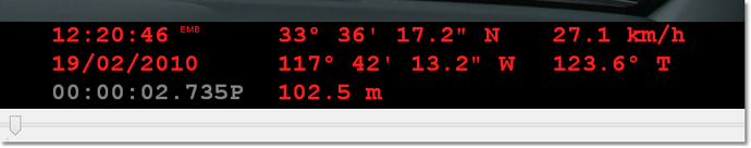

If Display Geotagging data is checked in Tools > Options > General, the metadata display is different to that described above. In this case the following metadata is displayed:
Metadata window pane (Display Geotagging Data)
•Presentation Time Stamp - hh:mm:ss.sss where sss is milliseconds (see above for an explanation of the PTS)
•Latitude - in degrees, minutes and seconds N or S
•Longitude - in degrees, minutes and seconds E or W
•Altitude - height above sea level in meters
•Speed - speed of camera's motion
•Track - direction of camera's motion in degrees
Note that Track is the direction that the camera is moving, not the direction that the lens is pointed.
Alternatively Latitude and Longitude can be displayed in decimal, and Altitude and Speed in imperial units by checking one of the corresponding GPS checkboxes in Tools > Options > General.

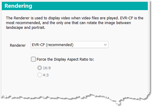

The Video Renderer is a component of Windows that actually displays the video image on the screen in DVMP Pro's player. You can choose between the MPC+, EVR-CP, EVR and VMR9 video renderers in Tools > Options > Rendering. However, it is recommended that you leave MPC+ selected as it is the most recent video renderer in Windows and usually the most efficient. EVR-CP is the next best choice, and VMR9 is now quite old and should be avoided if at all possible. Another reason to prefer MPC+ or EVR-CP is that they are the only renderers that can handle "portrait oriented" video correctly.
Some smartphone users record video by holding the phone "upright" (in portrait orientation), which results in video files where the image is lying on its side when played back on a TV or computer monitor. However, the smartphone usually stores orientation information in the file which can advise any software that plays or imports the file that it was originally shot with the camera/smartphone in portrait orientation. The software can check this advisory information, and if necessary rotate the displayed (or processed) video so that it appears in its original portrait orientation.
The only Windows renderers that are capable of rotating portrait oriented video so that it appears "upright" rather than lying on its side are the MPC+ and EVR-CP renderers. We therefore recommend that you always leave the default MPC+ selected in Tools > Options > Rendering. For more details of this setting, see Options - Rendering. For a better explanation of video orientation see the Portrait Oriented Video section.
If, as sometimes happens, the file's advisory information is incorrect or there is no advisory information at all, you can manually change the displayed orientation in the player by clicking the Play > Rotate Right menu. Alternatively you can simply press the R key - each key press will rotate the video through 90, 180 and 270 degrees.
Most of the time, video will be played with the correct Display Aspect Ratio, but you can also force it to display as 16:9 or 4:3 by using the Force Display Aspect Ratio setting in Tools > Options > Rendering.
